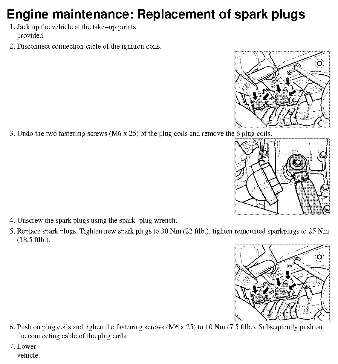

Just out of curiousity, how is easy is it to change the plugs? Any links would be appreciated too[
