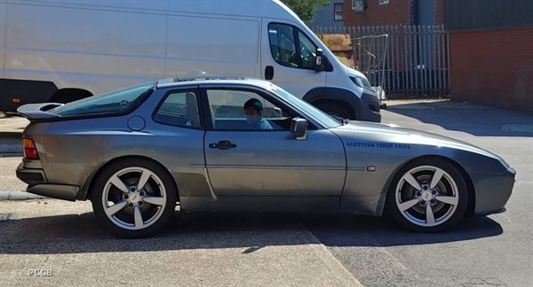

I think 18s can look a bit 'hot wheels' especially from the side, I remember watching Rick turn Wuf around from a distance and with the antennas on the roof and 18s it looked like a very cool RC car :)
I still want to try some different centre caps with these wheels,
Tony
:ROFLMAO:. I think because the spokes go to the edge of the rim, those Cayman wheels do look big. I might look out for a set.
