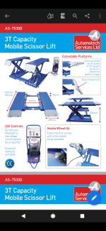

Considering a scissor lift for use in my garage.
Anyone used these types, the one without the car on, is around an extra £500.

Hi. I have the one in picture. Wish I’d bought one previously as it’s so much better than jacks and stands. Had a 110 Landrover on it no problem. However, Cayman is very low so I’ve had to adapt accordingly. It’s very well made and of good quality steel as mine is currently outside with little corrosion as a result. The biggest issue is it VERY HEAVY so difficult if you need to move around. The hoses and control box wires could do with being longer and of course the framework can get in the way sometimes but overall I’d say great investment. I have pics but struggle to upload but will try again.238798.jpeg236211.jpeg
That looks very good...are there safety devices...I mean do they physically lock when up to stop accidental lowering.
Yes. It uses hydraulic fluid to lift rams and air line to lift a safety bar over substantial toothed track. As lift raises it clicks into new position. When lowering it just lifts away from tracked teeth as fluid is returned to master cylinder. Hope that makes sense. I even tie down vehicles as extra precaution. For cayman underside it has key ways for inserting a lift block. I have aluminium ones but don’t like them as you then have metal on metal which can slide. Rubber blocks better but be careful of cracks forming from getting trapped.

Did you have to buy a separate compressor to power the locking system. The extra on/off ramps seemed expensive too. I expect most of the lifts come from China, just depends how much profit the various importers are charging for their stickers.
Compressor is separate. I already had one but small dedicated one is cheap enough. The ends of ramps are hinged to act as on off ramps or can be locked in situ to extend. I bought some rubber curb ramps off Gumtree to add to set up. It isn’t a cheap setup but I’ve always got something on it 😢. I had to obtain the mobility wheels separately which was frustrating. The control unit frame also acts as leverage when moving about on FLAT floor but the wheels on mine are weak….broken. Several makes are around and I’ve also seen the separate sizzor lifting ramps for each side but interestingly someone nearly had an accident with that type (YouTube 911 project).
