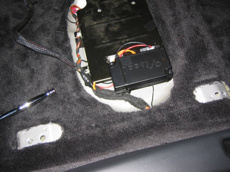

For those who asked, both on and off the forum, I fitted the ViseeO kit today.
Installation was easy once I had removed the driver's seat.. All I had to do was unplug the MOST cable from the existing telephone module, connect to a power supply and earth, and plug in the microphone and run the wire round the door seal to the top of the A pillar.
This is where I started fitting the unit, but once I got the seat back in I found that it just touched the underside, so I moved it to the back of the phone unit:

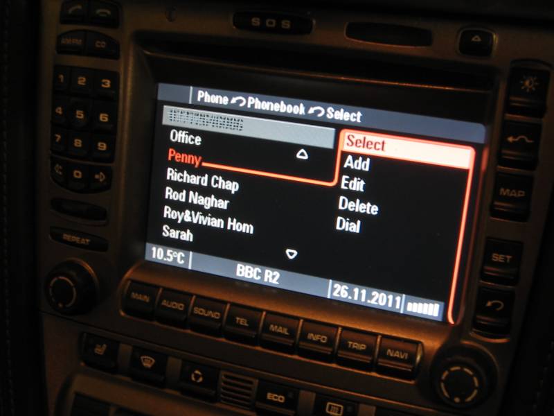

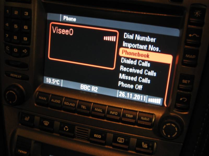

All the phone functions you would expect:
It took me a while to sync the phone book - it will only sync from phone memory, and I had all my contacts on the SIM. The phone side of things works really well, which was the main objective. Previously, I had a pay-and-go SIM card in the PCM and diverted to it when I was in the car. This device puts an end to that. The only thing I seem to have lost is the SMS text function, but to be honest I never used it, as it is far easier to text from my phone.
