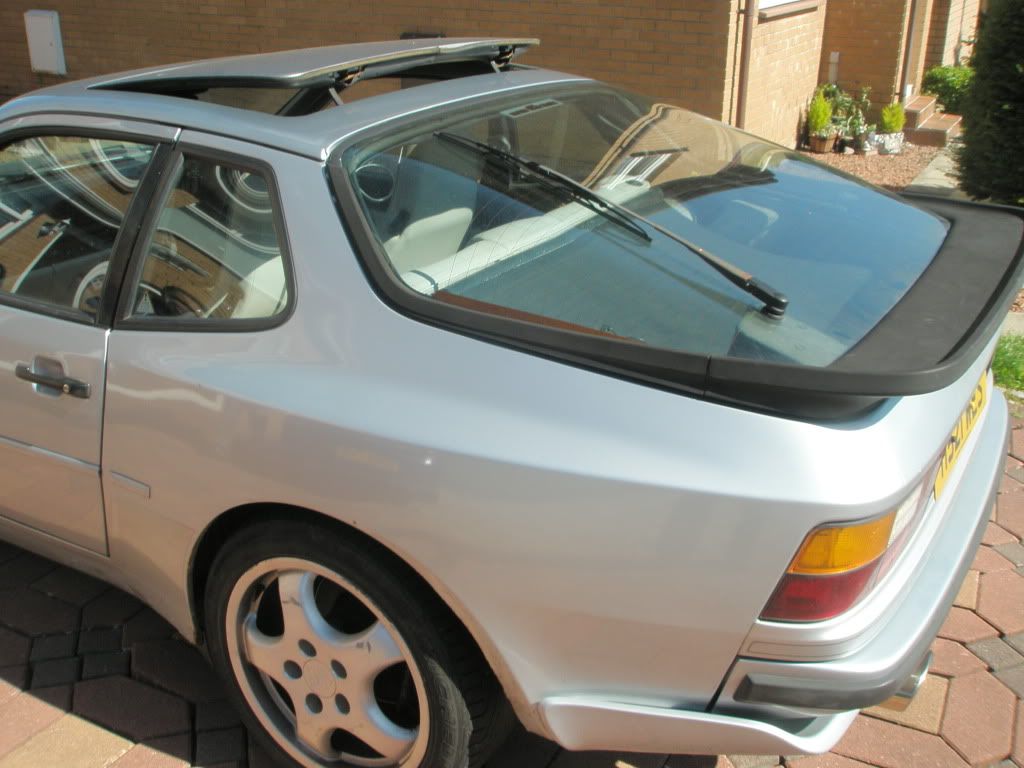

Just having a practice to see if I can post a photo, if this works I will post some photos tomorrow evening of the rear cards
no, you can't! lol [:)]
You have the right link to the photobucket picture. When you paste it you have to either click the icon of a postcard (top right when you're composing a post or reply), or more likely you'll see a row of options with "image" fourth from the right. Click this, and paste the link in to it, and you're good to go.
Usually you need the pictures URL starting 'http://www.photobucket...and ending .jpg' - you need to surround this with the forum picture code, which is slightly unusual in that it is rather than the more common [img]. The correct syntax will be, [i]without[/i] any spaces inside the square brackets, which Ive had to add in order that the command is visible, as opposed to a little red cross):
[image ]http://www.photobucketypeaccount/youraccount/album1/picture001.jpg[ /image]
If this wasnt made up itd have totally worked! [:D]
