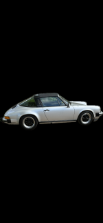

She’s nothing special but have owned her since 1988 so thought it about time she had some TLC!!
