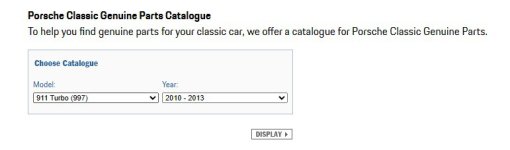

Parts file located ... https://www.porsche.com/uk/accessoriesandservice/classic/genuineparts/originalpartscatalogue/
Scroll down to ...
Display ... then view / download
Rear bracket is on - Illustration: 817-044
I initially used the non Turbo parts file but now having checked further, the Turbo is exactly the same
Update ...
817-044 relates to the Cabrio and shows the bracket 17
Whereas 817-040 relates to the Coupe and does NOT show the bracket hence my initial assumption may be incorrect
To check part relevance against the model / body style note the extreme right hand side of the diagram
