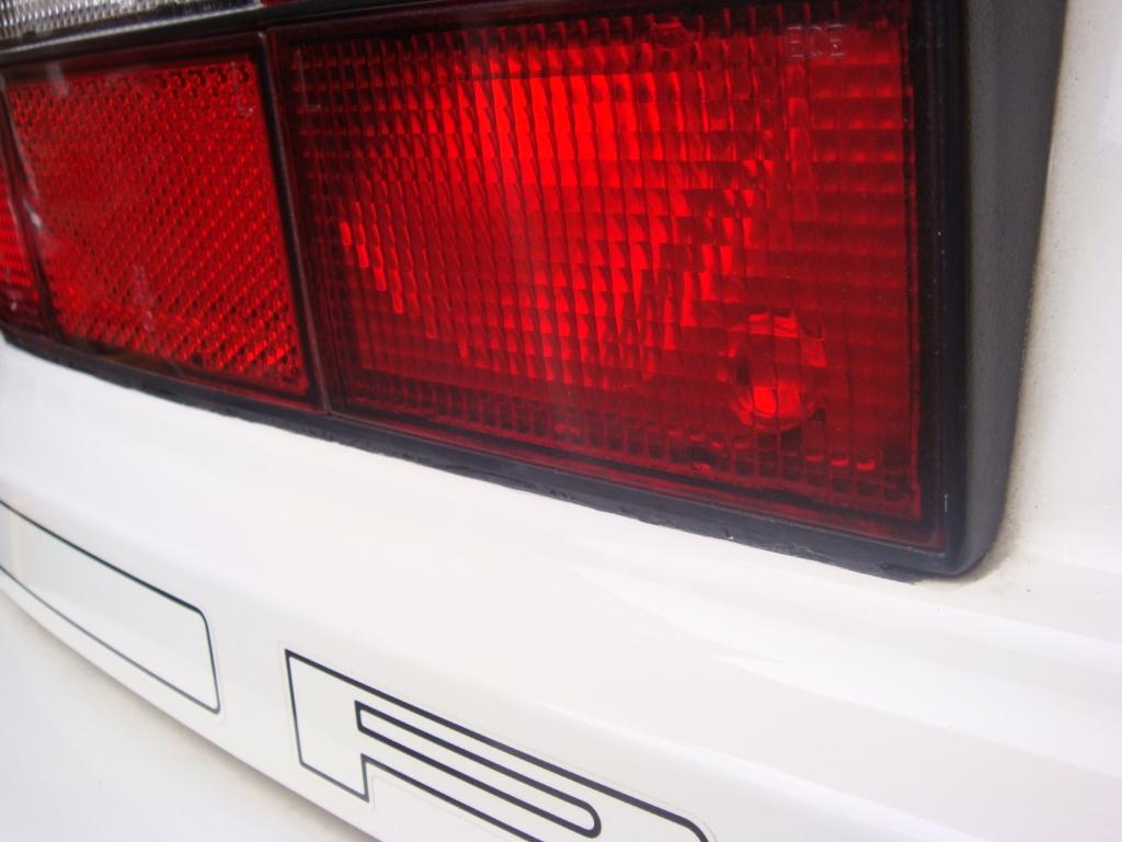

Mine's exactly the same, but I've managed to clean it up with a mild solvent (ie one that won't go for the paint) Can't recall which...either white spirit or meths, then more Autoglym on the paintwork afterwards. Anyway, the joint doesn't leak water!!

That's the right stuff, but is availably cheaper here, and in different colours to match your 944.
The other Woolie's lamp-sealing putty

ORIGINAL: Alpine
My rear lights have an unsightly sealant along the bottom edge, see pic below. After a while it stains the paintwork below, where the rain washes it downwards.
Has this sealant been there from new or added later, and if the latter does anyone know why?

... I can't recommend it. It may have been the best schnizzle when the cars were new but it ain't great now, and I struggled to make it seal properly. I ended up using some closed-foam insulation tape, as recommended by Scott, with a very light smear of clear silicone on top of it. Even that's not 100% waterproof, but it's a lot better than the proper stuff.
Oli.
Im surprised by that mine has been fine, what make was the tape you used? I bought some armaflex tape of e bay and cut it to size and doubled it up. Its good stuff, handy for eliminating rattles and I have even used it to build up seat bolsters when recovering seats.
