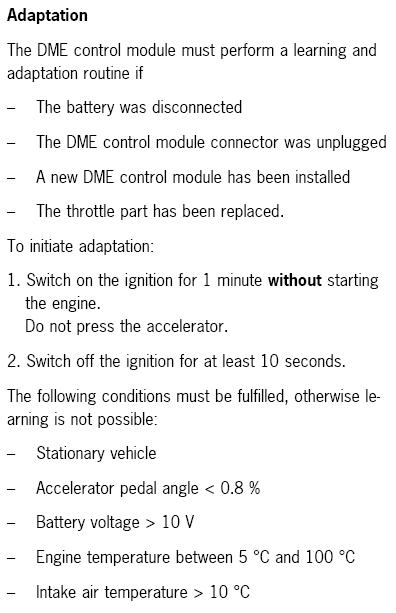

Have you performed a forced adaptation?
With a cold engine, turn the ignition on but do not start the car or touch the throttle & leave on for 1 minute. Turn off & turn ignition on for at least 10 seconds & then start. Go for a decent length drive over a mix of roads.

For early cars with mechanical throttle (DME5.2.2) you have to disconnect the battery for a few seonds. If you do this on an early car, make sure you have the radio code, and switch the ignition to position 1 before disconnecting, or the alarm siren will go off.
You have 7.8. Just follow the instructions. Just need to wait for a day when it is 10C............
