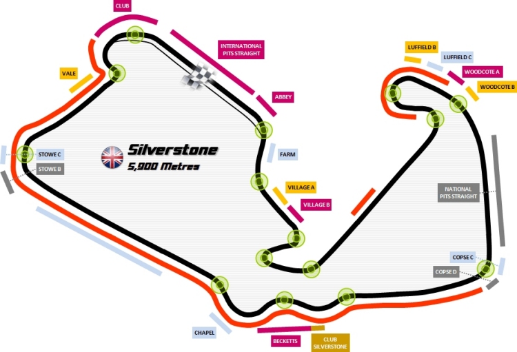

Just a quick update as promised before my car goes in for further changes. I did a track day in the mapped car on the new Silverstone GP circuit. I didn't really get a chance to learn the lines long enough before I pulled off fearing for a mechanical failure, turned out to be nothing once checked but better safe than sorry! However I did manage to get a really good feel for the changes brought by the remap.
The gains were far more obvious on the track I was able to hit 145mph consistently on Hanger straight with a passenger and the aircon on. This compares most closely to the Ariel Atom supercharged that could only manage 140mph and the 720hp 997 GT2 that was touching 160mph. Nothing else I saw made the 140+ bracket. So not bad for a basically standard 420hp turbo with a remap[:)]
On the bends the car on a hot dry day still managed to put all of the power down. It occasionally slipped the wheels a bit on the exit to 3rd gear corners but I never had to ease off. It also never scraped the arches or reached the suspension stops even though in the photos I could see it squatting quite hard under power. So suspension/chassis wise I'd say the car took the power increase very well. The biggest benefit came at vale - club (not sure how to make a link here?) where I would definitely have needed to go into 2nd in a standard car and then grab third mid bend for the exit. With the map I found I could stay in third and still be on boost into and all the way around 'club'. This gave fantastic flexibility and allowed a much smoother line through the bend (when I didn't out brake myself like I did most laps).
