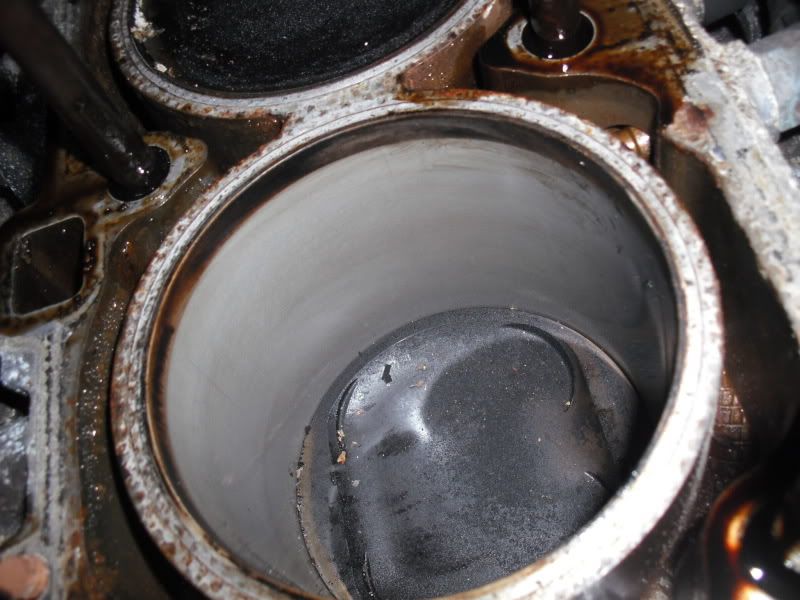

Having got the car home the first thing I did was a leakdown test on the engine (as this is the only bit I want), unfortunately cyl 3 was showing a 40% loss. At this point I was a bit gutted but the air seemed to be leaking into the coolant system which, since i'd be replacing all the gaskets anyway, wasn't a big issue - if your 944 hasn't had a headgasket yet it will need one soon, they seem to rot away after 20 years.

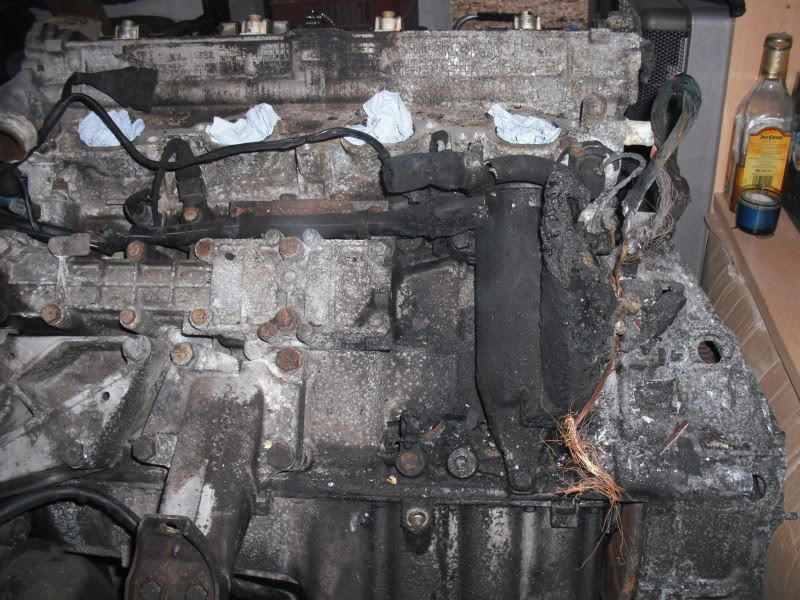

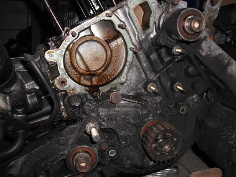

With the engine out I could give it the once over, you can see the fire damage & lack of oil filler!

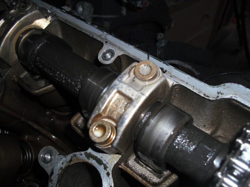

I removed the cam cover to check the state of the chain & tensioner (which look ok), the watery oil would suggest a headgasket issue.

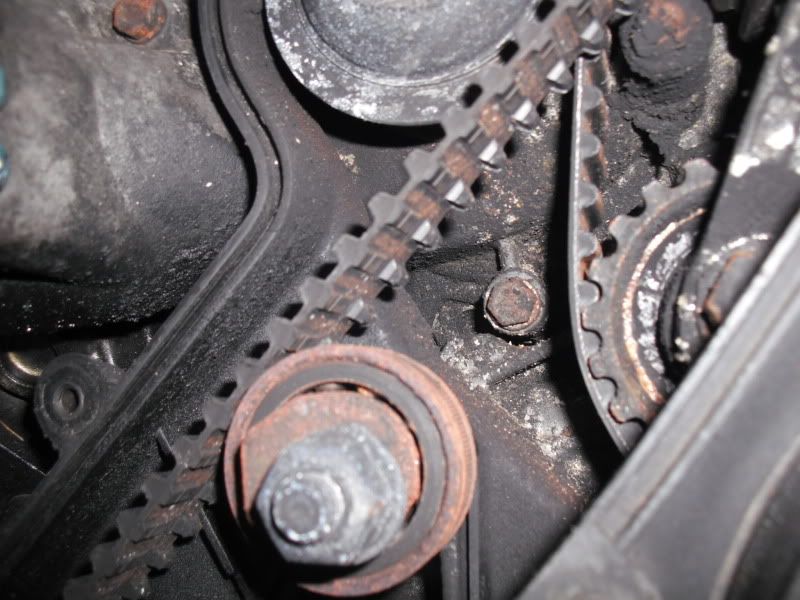

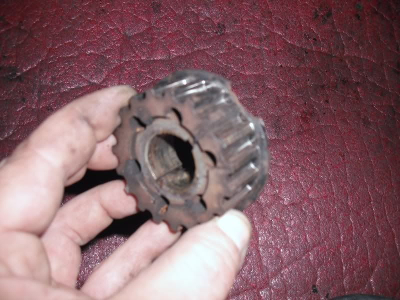

A quick peek in the belt cover revealed a horror, the balance idler seems to be missing the outer roller & the belt teeth are worn to nothing! A result poor workmanship.

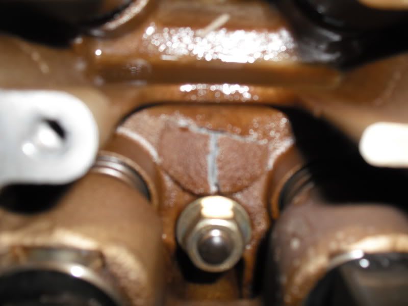

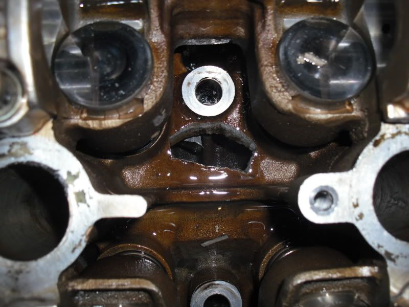

But the worst horror was the cylinder head. A fracture between cyl 1 & 2 is a serious problem, however the cause is a mystery at the moment. It appears to have been caused by something coming up and cracking the material but it is positioned right between the cylinders, above the water jacket. I'll pull the head in the next couple of days & have a closer look.
