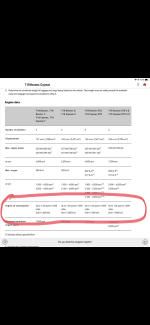

I apologise. I can see from the paperwork that consumption can be that high. That’s the problem with forums and I wouldn’t normally comment unless I had specific experience. My experience is that I have not had that kind of consumption on any car unless it was high mileage. Still stand by view of electronic measuring.
