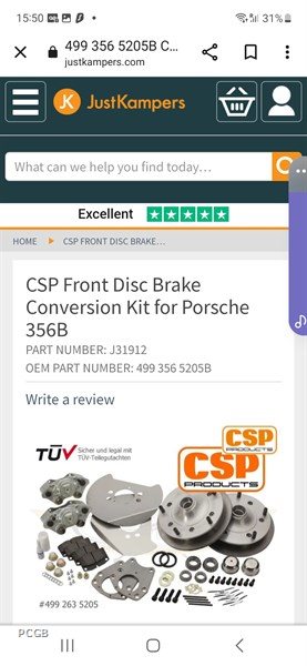

CSP Front Disc Brake Conversion Kit for Porsche 356BPart Number: J31912
Remove from basket
Qty- +
£1,175.00
