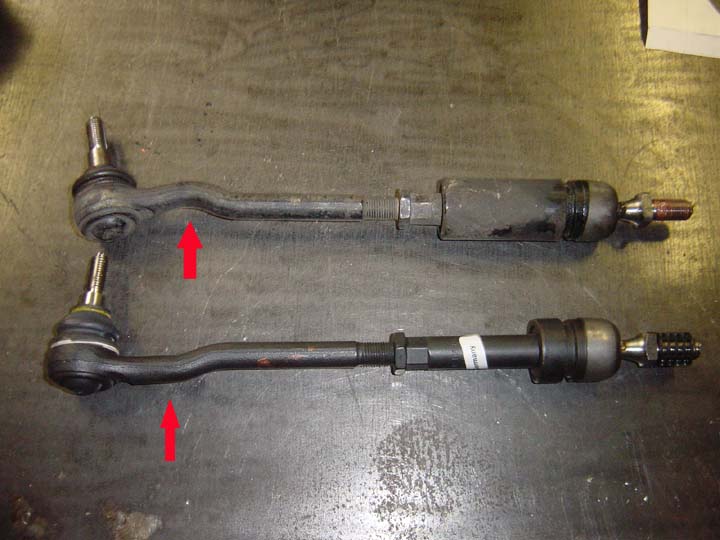

There are many reasons the car may do this from alihnment to worn dampers. It could also be the lower wishbone bushes, or it could be the steering tie rods. These have a lot of rubber in them and this perishes over age and may be worth a look at.
Couple of pics of the part. It's the upper part in the first pic, the second pic is of a cutaway of the part.
Thanks for the info & pics dudes. Always handy to be armed with some knowledge before taking the car to be looked at.
