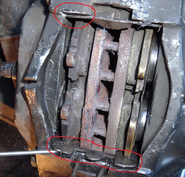

If you're doing this because your old calipers have plate lift, chances are those M6 threaded holes will be nicely clogged with oxidized aluminium, and old thread lock! This is where a 6.0 x 1.0mm tap bit comes in handy - if you've gone to all the effort, you might as well do it right in prep for the next time, by cleaning up those old threads!

So, what are the M6 bolts that brembo install from factory made from then, some sort of zinc plating maybe???
Might I be ok if they're well sealed in there, or is it just a no-goer?
vitesse
Active member
a) SS is preferable because they won't corrode,the socket in them won't corrode & then distort when removing them.
b) SS bolts are stronger than the equivalent mild steel particularly grade 316 but then no great tensile or shear strength is necessary -they only hold the plates in-& you would strip the threads in the caliper if torqued up higher than necessary.
c)If you coat the entire thread with a flexible type threadlock ,then this insulates the interfaces.
d) Plated high tensile capscrews are weaker than unplated .
& yes I could produce a comparitor table showing the relative periodic table positions of dissimilar metals-copper & steel are just as bad-theoretically-so he -ho brake lines.
I liberally coated the SS wear plates with copper ease grease ? to minimise the corrosive conditions between the mating surfaces having removed the aluminium muck & resprayed the calipers generously.
