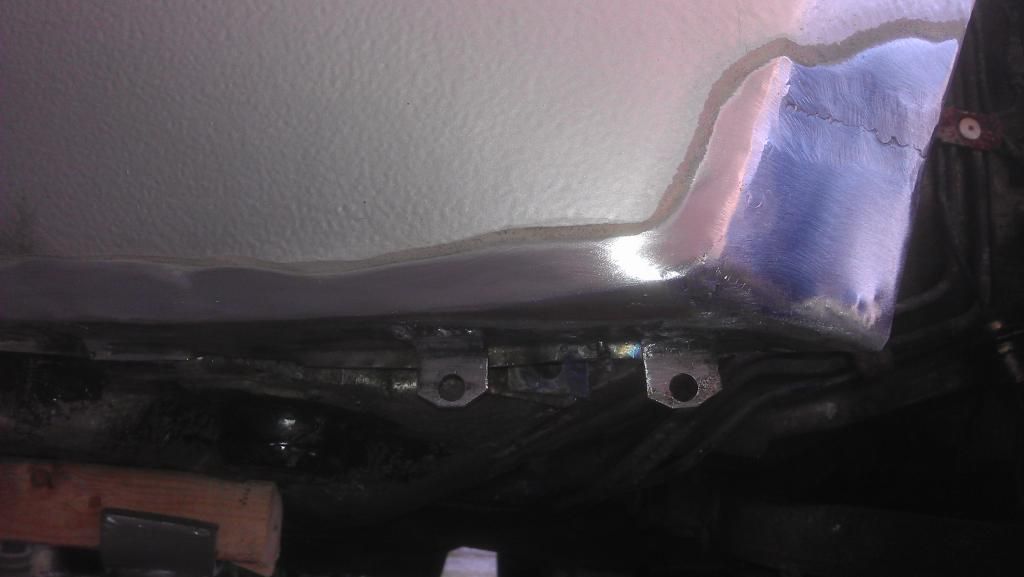

I did see the Ebay panels but to be honest they are a 10mins make from scratch.
Normaly these when you get them you have to cut and shunt them to fit anyway so it's a waste of £40 I feel.. £4 of sheet steel.
Use cardboard to gut the template out and go from there.. to get the 90 degree upturn ( the edge ) use plyers to skrink the metal and then finish it off with a body hammer and a flat surface OK I have a few more tools but that is about the jist of it.
for the inside I cheated abit and didn't do a 90 degree all the way round just the flat secton and then I punched holes though so it is just like the factory weld.
YOu can pull and push metal around alot. I now have the factory curve as it's not flat as people think. I made the rear brackets last night so those need spot welding in now and then whole lot can be painted then.. I am going to drill a hole from the vent inside the door, so I can inject wax oil into that area as you can't get to it.. and then put a plug in .. it will then make the water just run out into the main sill area and out the drip vent Porsche put in..

Wire wheel on the drill cleaned all that surface rust up nice.. so painted it all inside now..
Now to put abit of filler in the side there, don't need much as i managed to pull the 3 sections togeather nice.
I'm so far very pleased with the repair.. I have had a good poke around every where else as well and done some tidy up work there..

Got to this part was a pain because I had no reference as it rusted away, the other side is not much better.
Im happy even if its not factory its not far off, I added in a water drain in the wing as this should help. Im also going to put a plate in front of the corner to protect it from all the road dirt getting into the corner to rot..
