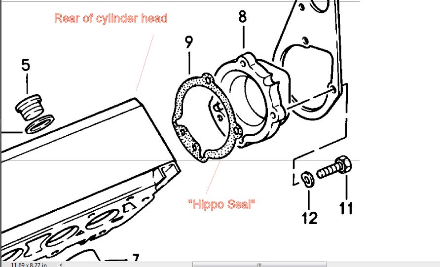

My two penn'orth. I had an oil leak on my 8v turbo. No name no blame, but it manifested itself after a journey back from the car having a complete once over by, let's just say, recognised experts. Turned out to be a leak from the amusingly named hippo seal, and when you remove the back (nearest the bulkhead) cam shaft end plate/housing and look at the cork seal you will immediately see why it is called a hippo seal. The interesting thing here is that one of the three 6mm bolt threads were stripped and I wonder how a bolt that is not moved during a 30,000 mile service, and previously uncomprimised and secure, can self-strip in situ. (and as a little aside I have heard some americans pronounce this 'in sytoo', but for them this is probably "normalcy" lol[:D]). The conclusion is obvious but difficult to prove. I had an interesting Sunday afternoon helicoiling the thread with the head in place on the car, (copious amounts of grease on the tap before you ask about swarf) as it is just a little awkward but achieveable. The net result was and still is a completely sealed hippo housing, and a note to self not to take the car to the same place for any more work.

On the back of the 15 1/2 valve head, (I'm sorry my six appears to have stopped working inexplicably) there seems to be two plugs, one appears to be threaded, on the other, behind the exhaust cam looks like a steel cup held in place by a steel strap and a single bolt. It might be worth getting in there with a rag and some meths to clean it all up then run it up and use a mirror to see if the leak is from there or, as been suggested, from the cam cover seal.
