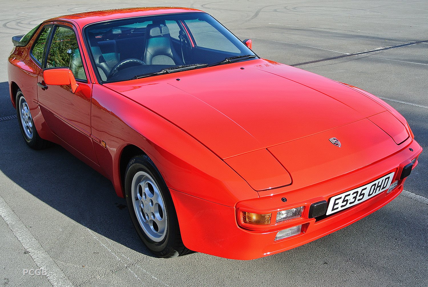

The garage gave the car a pretty clean bill of health mechanically, just advised on a bit of oil misting around the filter and slight play in the front suspension.
I haven't noticed any leaks and it has never dripped any oil. They said it was the cleanest 944 they had seen for many years.
They took it out for a drive and reckoned it's not far off where it should be on the tuning front despite my initial concerns.
They do service Porsches so I guess they know what these cars should be like to drive.
They pointed out that the OS main beam wasn't working but it did work at the recent MoT. When I got home I changed the bulb and tested it before putting the headlamp back together - all good. As soon as I had finished I tested it again and no main beam! Could be a wiring fault I guess. I found the headlamp awkward to extract due to the adjuster motor bottom left fouling the screw hole tab so I only just managed to change the bulb with it half out. Is there a knack to getting it fully out? I will have another attempt at the weekend.
They advised that the centre exhaust is a bit rusty. The rear silencer is also corroded so I have ordered a full Dansk system, plus a throttle cam.
Got a pretty good deal on the Dansk thanks to Cyber Monday. I hope that this and the cam will improve the throttle response.
I want to keep the car pretty much standard in appearance. The only thing I don't like is the steering wheel.
It looks good but doesn't feel great to use. I have a Momo Cavallino that was on my Golf and prefer the thicker rim so I might see how it looks.
The OE Kenwood radio/cassette isn't great and struggles to find radio stations despite a brand new windscreen but I do have a Becker Grand Prix head unit and CD changer to fit once they have been serviced and tested. I will also upgrade the speakers at the same time as they are well past their best. Any recommendations?
That’s a beutifall example congrats mate??
I also have a lux 1986 and although my turbo is quite a beast compared , I can tell you one thing from experience, they have totally different feels to them, and really are completely diferent becuase if it.
i havnt drove my lux since I bought my turbo due to a life time of chucking money at it and 2 engine changes and last one had low oil preasure that I couldn’t figure out why ( now I’m experienced I know why)
point is is I truly can’t wait to get the lux going again as I miss the feel of it as it was more raw and revy and felt more involved that way. The turbo especially in my state and I’m sure a few other which have modified there’s feels great in a totally different manor.
Only way I can explain it is its very very smooth but savagely fast and you drive it totally different. I love both but really miss the lux becuase if the raw revy feel and I used to drive it fast round the bends ect becuase the power it had allowed that, but my turbo you dearnt dream of having your foot anywhere near the exellerator pedal unless you wish to wrap the car round something as the power is way way too fast so you only plant it when there’s no cars up ahead of time and on the straight.
I plan to get my lux back soon as it’s still at my dads in a garage I’ve been renting since the age of 17 ???? ( what a waste of money!) and I plan to do a lightweight rollcage type project on it with lightweight rebuilt engine components flywheel ect so its even pokier and revier, and that thought really excites me! ??
yours is a beuty mine wasnt loved so much wheN I bought it back in the day but I knew very little and got fed up with paying so called soeacialists which fixed one thing but ruined another in the process, now I know what I’m doing and have done machanics for a few years becuase of it , I can enjoy fixing and messing about with it in the future.
Yours i I would say is a peach and a rare find in that sort of condition so congrats and enjoy It ????

Yes your car is lovely, enjoy her! Can't advise on the stereo although my screen aerial seems to be decent if not great, there is an amplifier for it which must be plugged in, so worth checking that out, it needs power from the stereo, black wire I think but stereo wiring is notorious for being savaged.
Your headlight issue will most likely be the loom where it bends before the headlight, due to years of popping up and down. This was the case with my NS one. Fixed it and its been good ever since.

Can I ask what you paid for her ? Looks a lovely example ??
It was less than I got paid out for my MK2 Golf. [:)]
