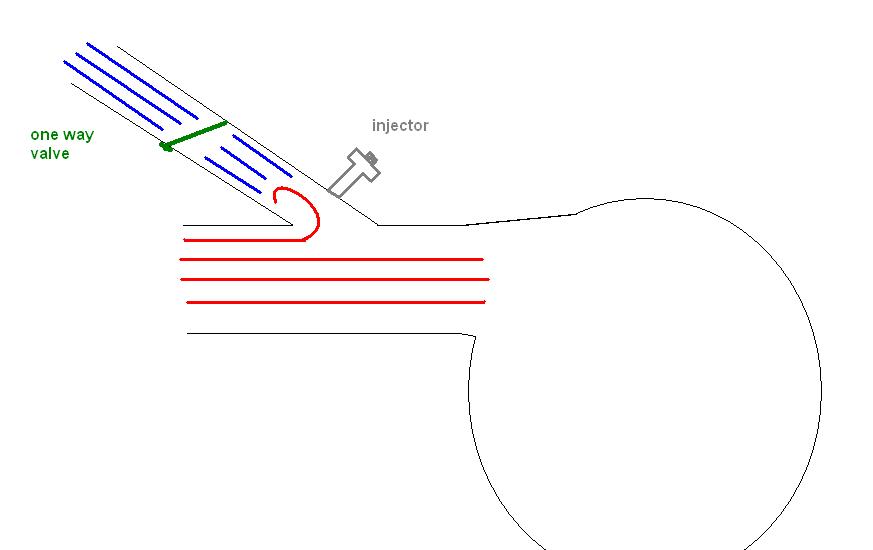

Beat me too it with the DV valve/backflow issue. I thought about it just after I posted. I thought a design like this should prevent backflow into the intake and also hopefully reduce pressure allowing inlet air to escape into the flow of exhaust gas more easily?
Scott I think the explosion is what is desired with these systems but with the rapid expansion finding it easier to spin the turbo to escape than blow the exhaust apart. I wouldn't be risking it if it hadn't been done.
I know there are far less dramatic ways to reduce lag but I thought it might allow me to use a larger than normal turbo without making it undrivable when I fancy putting in a quick lap of winning a race. Anyway its not all about speed, I like a capable car for sure but I also like the drama and it's far more exciting to see a car with a huge turbo lunging and flame spitting than a probably more capable but totally drama free 997 turbo putting in good times.
I had hoped the reason its not popular would be because its hard to sell the idea of wasting fuel to the public. It is still used widely in competition so it can't be that ineffective. I do worry however about the number of people saying turbo lifespan is still an issue. I wouldn't be running it all the time but if it kills my turbo every 5,000miles that could get annoying/expensive. I might try it once and see what occurs, just want to ask around first because responses like that one about back pressure are very helpful. Thanks all.
