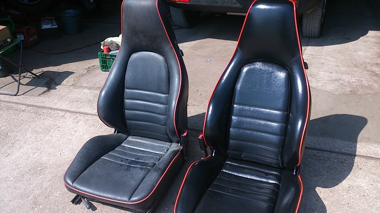

Seats - before and after
its a bit shiny but coated it in coach leather wax to bring it back to life - will clean the excess off later
and another

Jabriel - plenty of elbow grease, washing up liquid and warm water, Vaseline plastered on and left to soak in, dry, coach leather wax, buff and remove and repeat again.
thanks andy
