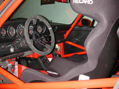

Picture below of later Cup Car "SuperCup" which was honed from the 964RS Chassis which was specially built to homolgate the N/GT SuperCup series NO C2 Conversions here.....
Des

I've had the extra hole drilled in the rear shelf on my Cup Car because due to the design of the Schroth belts I could not get them tight enough (behave!) from the cage alone.
However, I have since learnt that in a heavy accident the rear parcel shelf can deform with the load........
