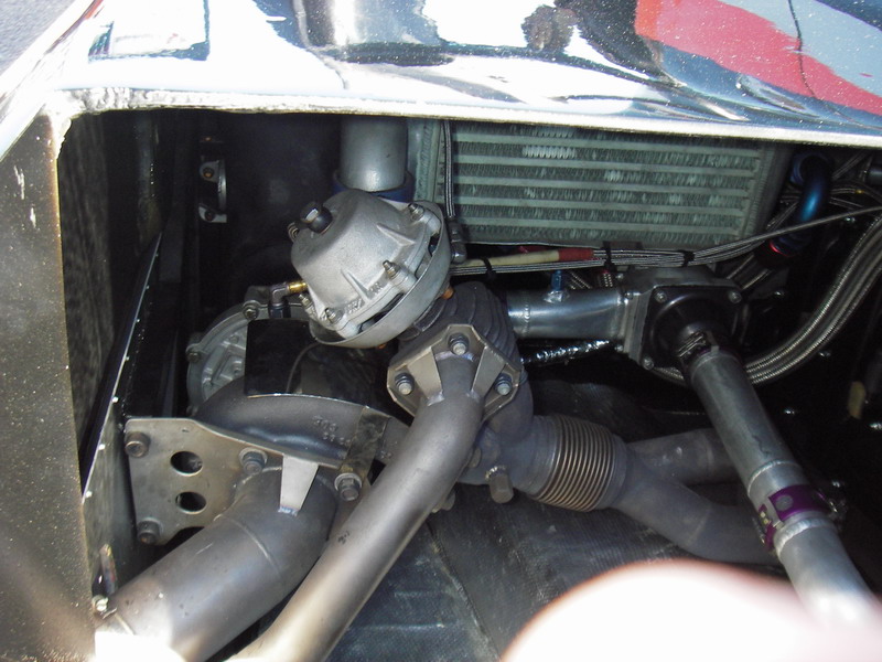

~Just to give you something to think about on this topic I was speaking to a chap who builds the exhausts for rally cars (he seemed to know his stuff too!) I asked him about designing me an exhaust dumping to atmosphere to avoid pressure in the exhaust and he said that its not as good as the standard design, infact he really liked the design used on the 944?!
According to him the added gasses do not pose a problem because they join the main exhaust far enough away from the engine and it creates a possitive effect because the flow of exhaust gasses create a vacuum affect which draws the gasses away from the wastgate avoiding back pressure. I'm only relying on his word but he was building the exhausts for the current Citreon WRC cars a year or so ago and they did quite well;-)
I'm guessing he wasn't using a Lindsey wg either!!!!
