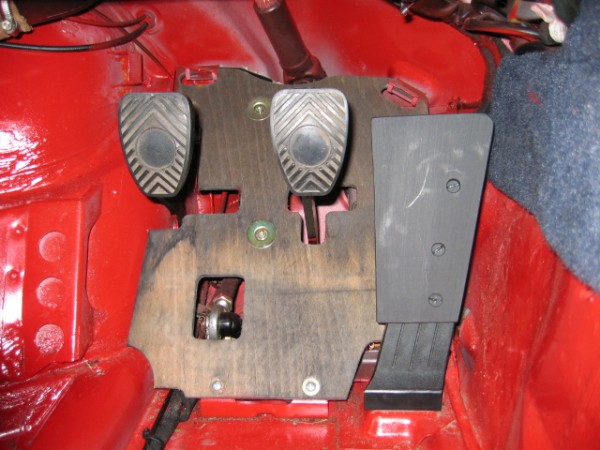

Had another look at mine and its the actual pedal heights that are wrong - the accelerator pedal sits so much lower than the brake pedal. I'll investigate the idea of fitting an extra pedal carefully on top of the existing accelerator pedal. However, I'm going to give the car a good check over this week (first track day at Knockhill next weekend) and I'll check if its possible to 'adjust' the height of the accelerator pedal. Bet Schumacher never has this grief...

Just a note but, I wouldn't worry too much about the static heights of the pedals. When you H & T whilst actually driving, especially on the track, the brake pedal will be a lot lower as you will be applying the brakes at the time. Unlike my early 911 which is perfect for H & T, I thought I was going to have to mod the pedal on my Crossfire when I first sat in it in the showroom, but its not actually a problem on the road or track.

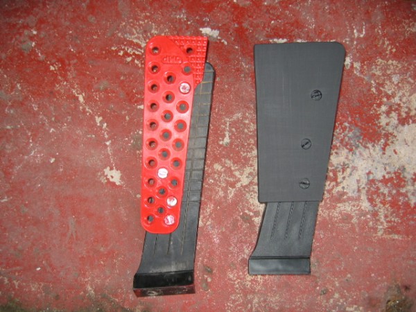

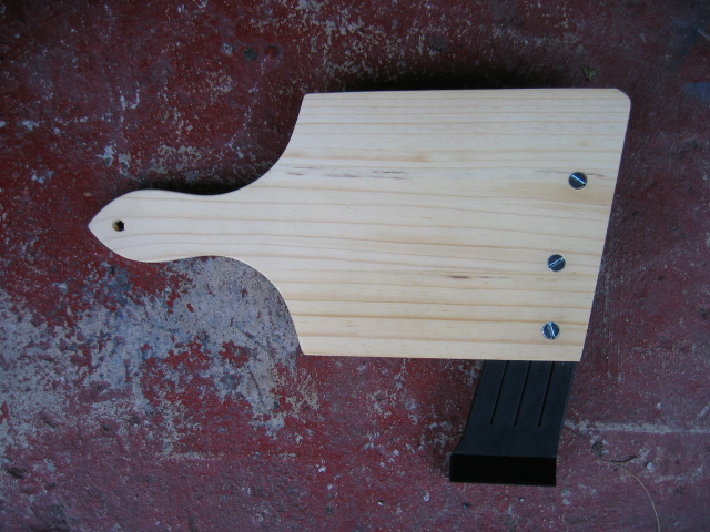

Keith - your DIY extender is Superb [:D]
I've always found the S2 a bit of a bugg4r to H&T ~ trickier than any other car I've driven in fact. This may well provide the solution..... [8D]

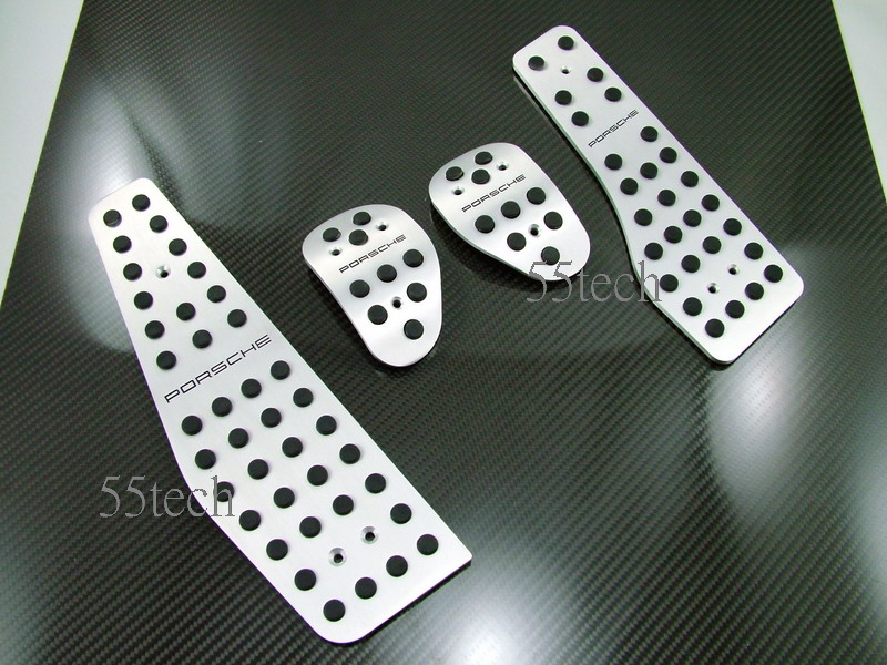

then enjoy spending the £281 you have saved by not buying these RUF ones........
http://www.essentialstyling.com/boxster_pedals_sets.htm
Or the whole £77.00 I spent on these incl shipping
The thing is when I bolted a wooden block to my SC pedal it needed to be about 20mm thick to
bring it up to the right level.
I suppose it depends on the individual cars pedal positions but that particular pedal cover looks a bit
thin to make enough difference!
