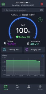

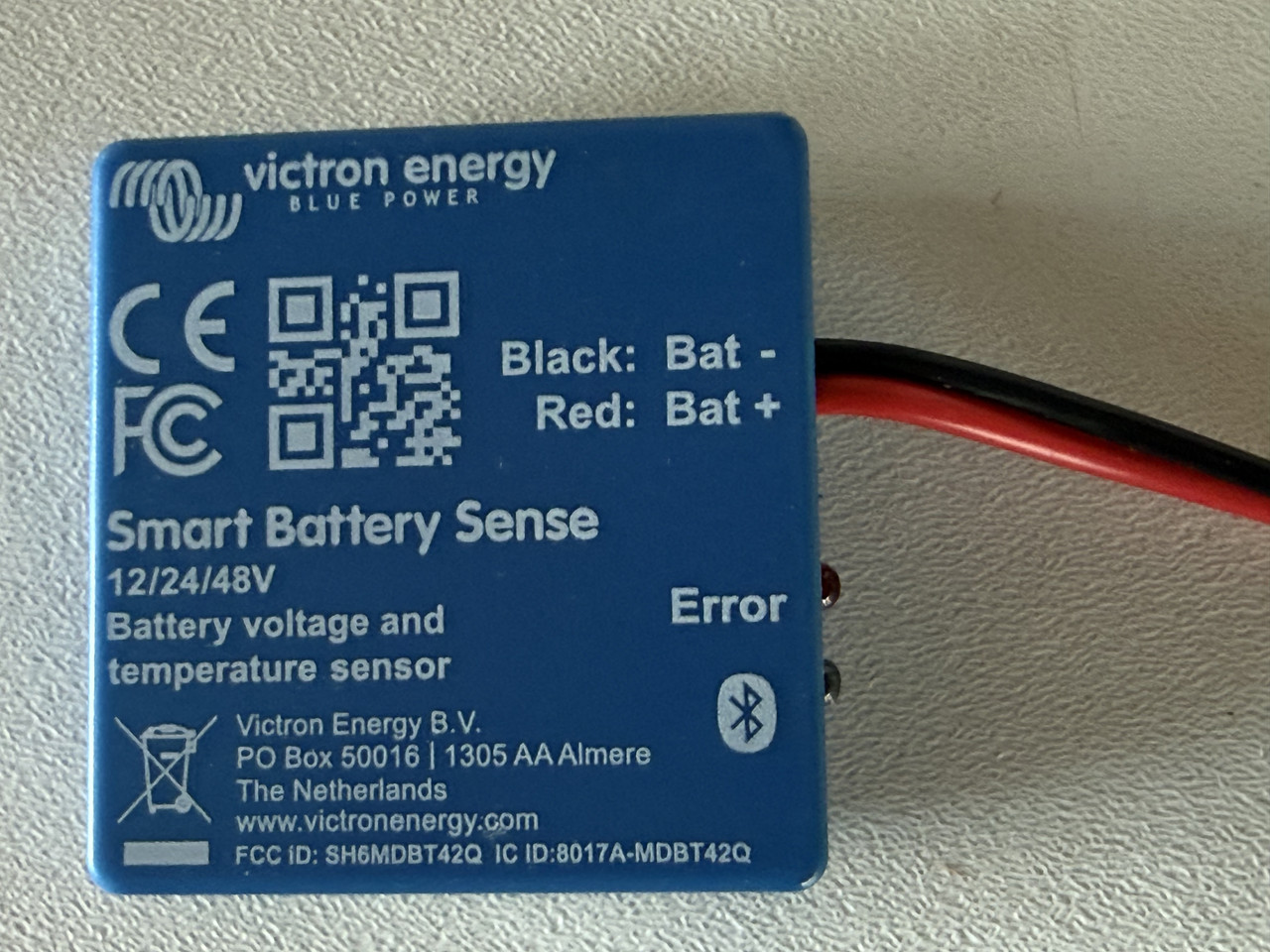

I use this device which connects via Bluetooth to periodically check battery voltage.
and on my phone I see this..
There is most probably your problem, 4500 miles in 4 years. These cars really don't like to be sat about and should be driven.
