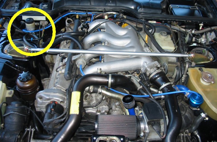

Sounds more like the clutch whon't release, to me. Have you checked the fluid for your clutch pedal? Are you losing any? could be the clutch master or slave cylinder leaking perhaps? Does it work if you pump the pedal?
ricky944
John,
Sorry i am not that technical when it comes to the oily bits whereabouts are these bits located..??
No..........i tried pumping the pedal a few times and still no joy
Had a look on garage floor nothing to report of any leakage.
Dont understand this at all..........its fine when engine is off.......goes into gear easily........but soon as fired up........shoots forward and will not come out of gear
If the clutch isn't disengaging you have the effect of the engine being connected directly to the gear box i.e. you can't release the gears from the engine when the engine is running. When the engine is switched off, there is sufficient movement to allow the gear cogs to slide past each other.

Those boys at JZ Machtech are fantastic...!!!
It was only the clutch cross shaft that had come undone.
(any one got a pic as they did explain to me but i am no mechanic)
Turns out to have no leaks......clutch is fine....all in all an hrs labour.
