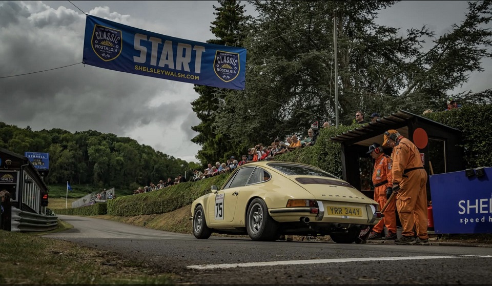

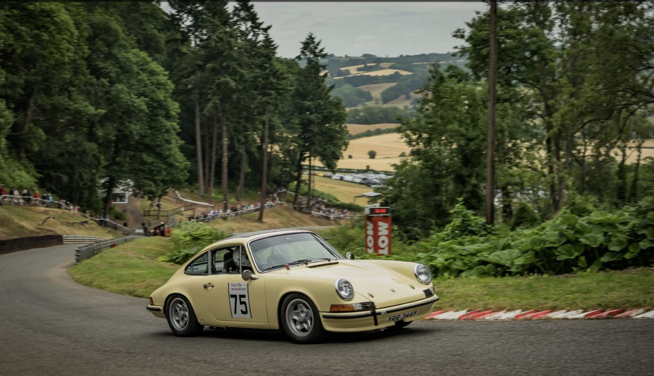

Am I allowed to bring an old 911 into all this modern water cooled stuff? lol
Absolutely Graham! Much as I admire the later 9XX cars, you really can’t beat a genuine 911.
Some great pics there.👍
Jeff
None mine, but by Stuart Wing a real pro at catching cars 'just so'.
We are allowed open pipes for the meeting, so lots of evocative soundtracks...
Oddly, the open 911 engine meets the correct noise levels with all 3 pipes open.
