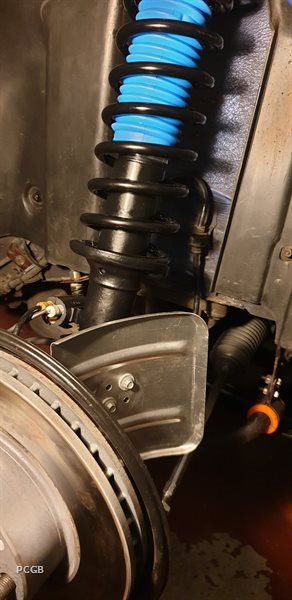

One question, it appears that the brakes used to have a scoop for directing air for cooling. Neither side has them but the parts catalogue shows that they weren't an optional fit. They're not too expensive so is it worth purchasing new ones and fitting whilst I'm there or not bother? The catalogue shows that they are retained with 4 self tappers, there doesn't appear to be a thread to engage though.

I think the air scoops fit with m6(ish) screws on a bracket and they are important as there is an upwards deflection in the under tray that channels air up to it, it then deflects air into the centre of the disc. (some cars have a duct from the front through the arch liner that aims air at the same deflector). If the brackets are missing form your struts you might be able to run brake hose to the disc centre instead, and hold it the the strut with cable ties.

Thanks Tony! Very helpful. Odd how it didn't have them in the first place!
I picked them (along with the flanged bolts and Washers) up from Porsche a week ago and fitted them. Only £24 each (£55 for the whole lot). Very pleased!
I also replaced the track rods and track rod ends whilst I was there as one of them is cross threaded and never been sorted so whilst the access was good and it's being aligned soon it was worth doing. Coildnt work out what to torque the track rod end to do went for 40nm in the end. Seemed about right!!
