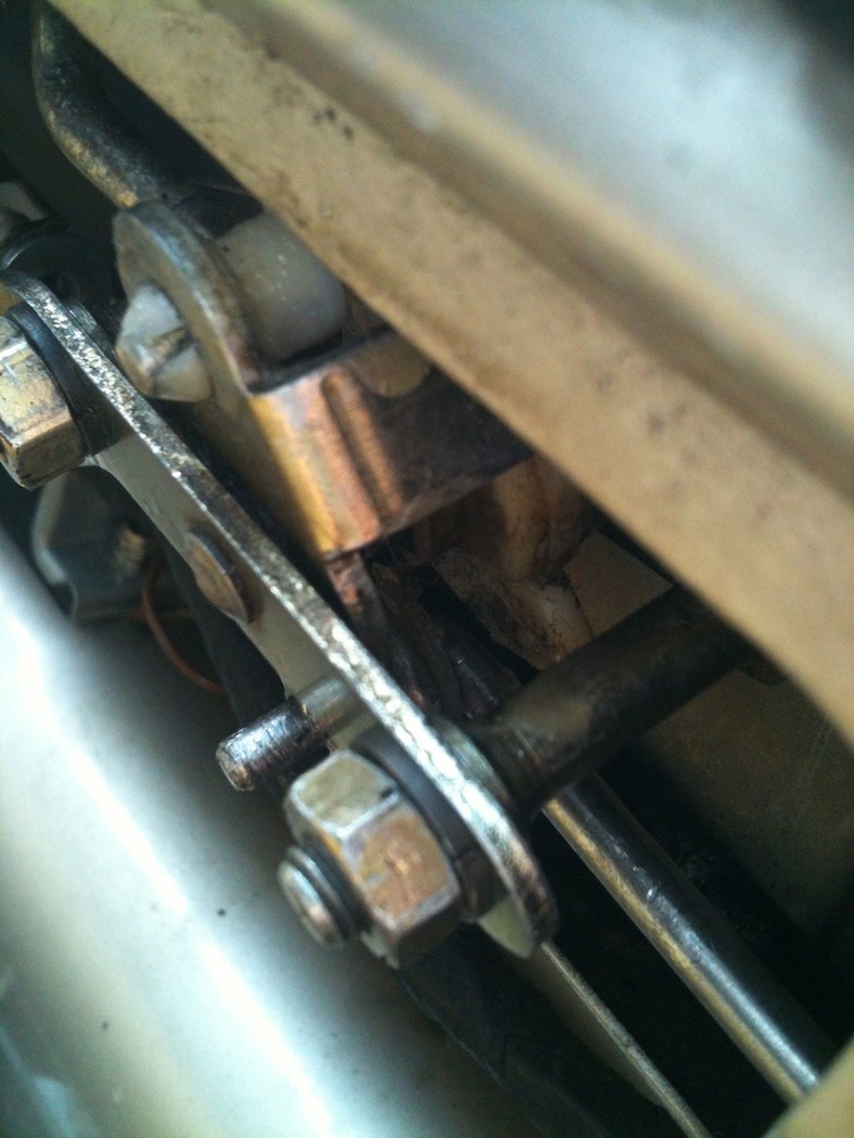

here's a pic of my '89. The white plastic wheel at the rear of the lock has a raised lump that you can see at the 4 o'clock position. If the key would turn clockwise (which it won't) that would push against the metal tab (the big tab at the 2 o'clock position) and mechanically open the boot. Those two items don't take any part in the electrical opening process, so I guess they initially provided mechanical opening, then it was electrical-only, then in 1990 they were removed. Am tempted to take the lock barrel out and fettle it with a needle file so the key turns both ways.
