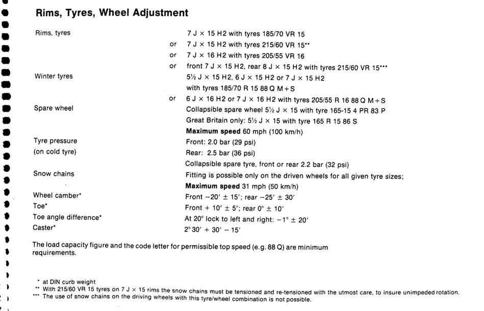

manual page;
mines on 195/65 r15.
That chart is for late offset wheels - I seem to recall the sizes posted by the OP sound about right for an early offset car - mine were different front to rear when on 15" rims, both American spec and UK.

If possible, could some of you help me on a definitive answer on the *correct* tyre sizes. The manual for mine states -
Someone mentioned that the manual listings are incorrect :S Why would that be the case?

Sounds like from the manual I should have 215/60 on both front and rear! Which Mike suggests. Does that mean I should also stick to having 29psi in the front and 36psi in the rear?

Very early cars came with 185/70/15 tyres: theyre rubbish. Later fitments were listed as 195/65/15 and 215/60/15 - cars came from the factory with 215/60/15s.
