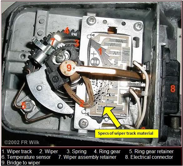

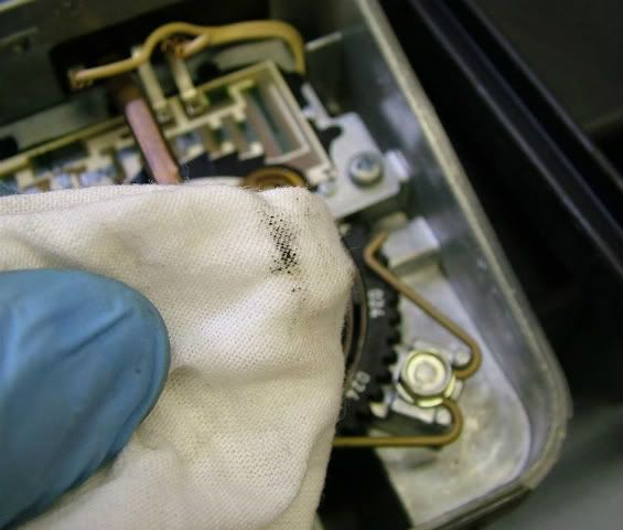

Like [link=http://www.youtube.com/watch?v=-11J8XawQtc]this.[/link] I guess care needs to be taken so as not to put too much, or too little pressure on the track.ORIGINAL: A9XXC If the tracks are worn etc its quite easy to get the contacts to run on a fresh piece of track, just by moving the bracket up or down the spindle.
