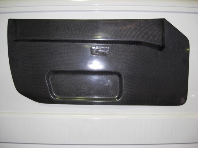

Mark - don't suppose you had door cards fitted to your race car did you? I'm waiting on Alex at EMC to get me some pictures and prices but wondered if you had any pics in the meantime?
Hiya,there was a build thread on the car for the whole time I had the car,it is called "Something I have been working on" I have checked and it is still there I just had a search for it and there are picks of the door cards on page 4 or 5 or thereabouts,maybe someone knows how to put a link to it?
The thread shows the car looking like a Silver rose to a road legal race car,you might find some of the pics interesting?
Best of luck with yours you will have a lot of fun I am sure![:)]
jpg
Nice, but minty. Ive ummed and arghed about these since 2008...
