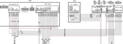

Has anybody fitted a Dynavin N7 radio. I need the cable to connect to a 996 Turbo with a Bose system. Connection block A is ok. I need Connection block B to C1,C2,C3 (mini ISO)
The unit powers up but no sound.
It sounds like you have the Bose amp with wired connections to the head unit (MY2001-2002)? You need to connect a switched 12v supply to the wire on C6 which connects to the amp and subwoofer amp. It is just a signal, so doesn't need much current, so most people tap into the aerial amplifier supply on plug A. In other words, connect A5 to C6. I've attached the wiring diagram for reference, and marked up the connections to the amp(s) in red.
