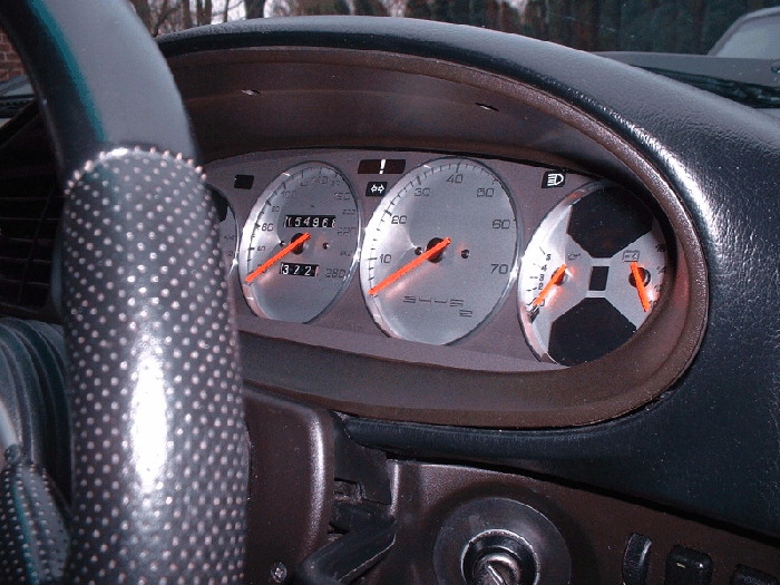

I've pasted a copy of a recent email and pictures from the 944 list about a German company that does white or aluminium dial faces as well as chrome rings to go round each individual gauge. This post came from Martyn Cockram the 944 Register Secretary who currently lives in Germany nearby to this manufacturer:
Further to some recent mail on the subject, I went and had a look at the aluminium dial facings and chrome bezels as advertised at http://www.tachodesign.de The guy showed me the 944 instrument cluster that features on the web site in the flesh so to speak that do look the canines gonads.
So much so that I have already ordered my set. Only problem being that I couldn't take them then and there as he only (naturally) has all KPH ones in stock. He is making me a MPH/KPH set up and it will take about a week. The other thing he mentioned is that on the rev counter, he can inscribe Porsche or 944 or both. To have this done will cost that little bit extra but should look good.

Wow ... I'm not personally wild about the aluminium look, but the chance to have the "968" script, or perhaps "Club Sport" on the dials would be seriously cool, just like Porsche do with the GT3 dials. Not a bad price either.
