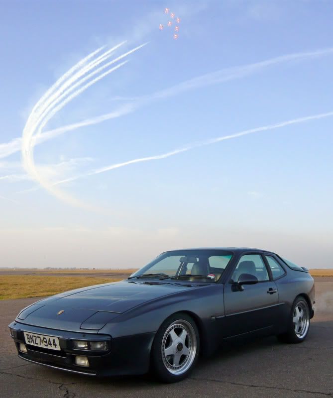

I tend to agree that tear drops and clear lenses better suit the S.2 and turbo. I'd have tear drops on mine if it wasn't for the cost and that I'd have to have both doors sprayed again as the difference in base would be very apparent.
However, here's one exception that I particularly like, photo courtesy of smiffyraf
