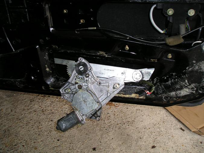

Well... the window sort of "clunks" at the extremes of its travel - the glass jumps the last half centimetre of its travel, so I'm trying to find what's broken.

I reconnected the motor, closed the mechanism right up, then slid it backwards until the motor was level with the front of the lower rear hole in the inner door skin. You can then rotate the lower edge out through the hole and extract the scissors, without any levering at all [;)]
Operating the motor with the mechanism off the door showed an obvious "jump" in the travel and splitting the motor from the scissors (with the mechanism against the "up" stop, as it's spring loaded!!!) caused the culprit to drop out - one of the teeth of the small cog that the motor drives [:(]

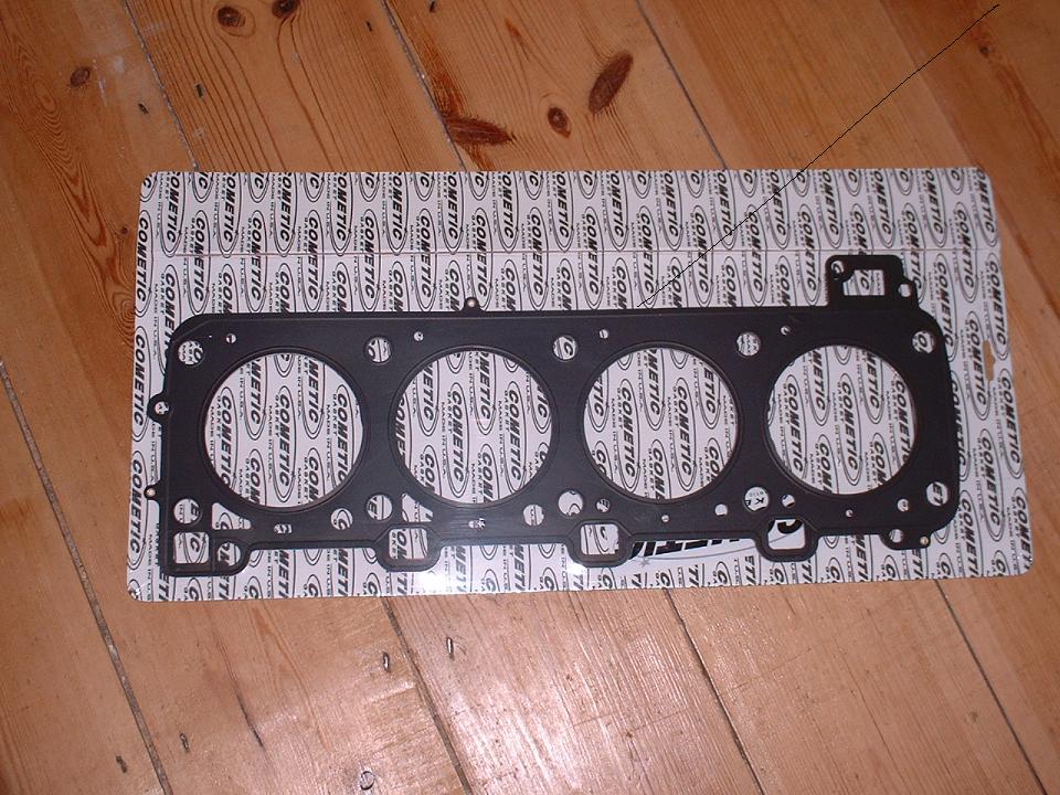

In the tradition of me posting pics that nobody is interested in, here's my fancy head gasket:

It's a Multi Layer Steel (MLS) gasket with 2 thin steel layers and a pair of figure 8 pieces sandwiched in between that sit around the bore tops (at least the one I looked at at Autosport was like that).
The guy doing my engine machining used to use them when he worked at Janspeed and built Nissan touring car engines. He says they can be reused 3 or 4 times and he has seen engines that detted enough to destroy the top of the bore but the gasket was still fine.
Hopefully I won't emulate the last bit...
