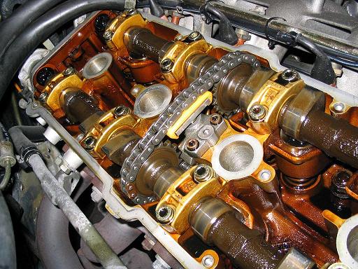

Took a look at the cam yesterday and got a pic with my phone (hence vague quality!). Teeth clearly missing, but slipper pad appears totally intact. Do you reckon the tensioner has caused this? Suspect gasket shows oil build-up around (and into) plugs. Replacement cam has arrived and will be fitted shortly. £300 labour, £49 cam. Could be worse!!

Interesting, I can't see why the cam would loose teeth wth no apparent chain/tensioner damage.
Do the other teeth look worn?
You mention a price for one cam, are you not replacing the tensioner, chain and the other cam at the same time?
The cam teeth can fail due to the chain stretching over time. The distance between links increases, therefore putting pressure on the sides of the teeth as the chain engages. Same thing actually happens to bicycle cassettes - chain stretch accelerates wear of the teeth - they don't usually break though, just wear down. The chain should be replaced at least every 50,000 miles, probably 30,000 would be a safer bet.

Just found this http://www.porscheshop.co.uk/acatalog/porsche_944_engine_components.html which has the cam chain for £20. it seems like it's one piece so I guess that means cams out, which means cambelt off [:(]
I changed the tensioner pad in mine when I got it but didn't look closely at the teeth. Might have to open it up again and inspect the cam teeth as I'm getting worried now!
It'd be good to have a good, close up photo of a new cam so we can compare to the original tooth profile and see how much wear there is.
I think Rick had pretty good pics when he did the slipper on baby Wuf. Anyone care to search his millions of pictures for me? [&:]
