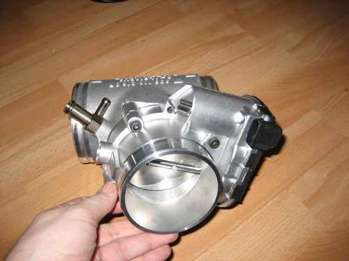

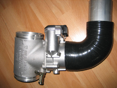

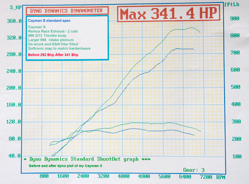

did all the tuning on a gen 1 Cayman a few years back. So you got the 996 GT3 throttle body and plenum now ?. my before and after rr at a indy who did not know I had changed any parts on my car. I also used Softronic and ran the car as a daily for 2 years with no issues.
the 996 GT3 bits
