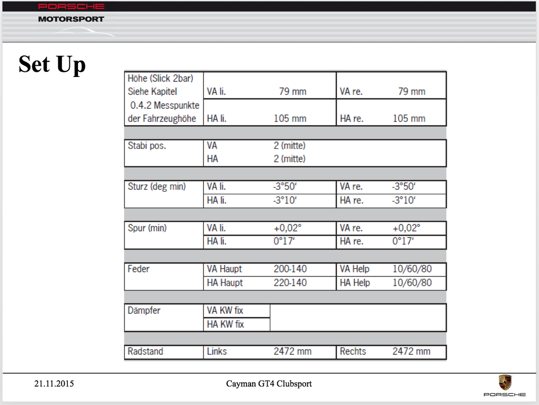

Interesting discussion, I have always run with more camber (between 0.5 to 0.75 degrees) at the front. GT4 Clubsport race cars (albeit with amongst other differences much stiffer springs, different dampers and slicks) are similar with front camber 0.4 degrees greater than rear as below for 981 version.
But with my latest Center Gravity set-up having fitted rear Motorsport TCAs to allow more rear camber without the previous ride height reduction, rear camber was increased to 2:25 matching the front, with toe remaining at 0.02' and 0.13' each side, front and rear respectively. Ride height was raised c10mm front and rear See reasons here Post #176
