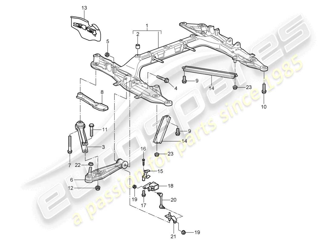

So i had the Cayman 2.7 into the OPC a few months ago for a free health check with the Porsche Club, never really found much apart from a small oil leak and the rear leveling sensor seems to be melted but still working, so i will have this changed hopefully by myself, when the weather is warmer, however even the OPC could not find a relevent service procedure or part numbers, has anyone got any info on this part? also looking through the service history and receipts the car has had Minor and Major services and a few odds and ends, but nothing I can see around suspension or bush replacement, and given the car is from 2007, just seems odd. Nothing came up on the inspection, but i would have suspected the bushes etc to be going pretty solid after this time, only 86k but still think thats a long time on the same suspension set-up, any comments on both questions gratefully accepted

Looks like it could be part 18 in the diagram

2007 (987 Cayman) Cross member Wishbone Diagram (401-000)
Quickly find Cross member Wishbone parts for the Porsche 2007 (987 Cayman) using the exploded parts diagram at Eurospares.

There are two level sensors on the 987.1, one for the front and one for the rear, which share the same part number 997 631 121 00.
If you need to replace the links [braces] the respective part numbers front and rear are 997 341 375 01 and 987 331 375 00.

Shocked that the OPC couldn't come up with the part, it is in the official parts list (attached). Parts lists for all models no longer in production used to be available to download from the Porsche Classic web page, https://www.porsche.com/uk/accessoriesandservice/classic/originalpartscatalogue/, but everything after 986/996 disappeared a couple of years ago. I had previously downloaded copies of the parts lists for all of the post 2004 911/Boxster/Cayman models.however even the OPC could not find a relevent service procedure or part numbers, has anyone got any info on this part?
