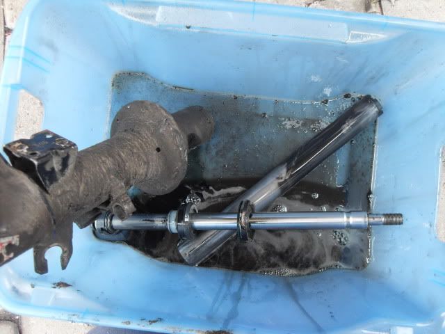

Started yesterday to put into parts few sets of original Sachs. Struts are now in parts and still having an overnight citric acid path. I'll go today to sand blaster's place to have struts blasted. After that they will be modified to have some threads, which allows Bilsteins to be screwd in. Struts will be powder coated as well. A former 968 set will be done firts; it will go under my friends S2 cab, which i am just converting to Turbo cab. Engine came from Steve/Alasdair

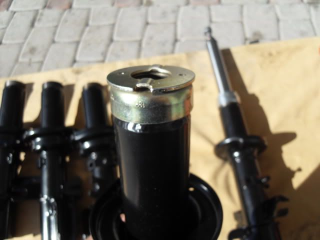

Starting point. A former 968 Sachs strut. Got this set up from a friend of mine, he changed to Koni yellows we refurbed for his 968

OK, here's what i have done so far. First remved the top cap. I just cutted it off using an angle grinder

I removed Tectyl undercoating from the struts. It is nice job to do for a blaster man... Undercoatings are pita to blast away [
Now i just need to take struts off the citric acid bath. Put them to bath just to help blaster mans work.
