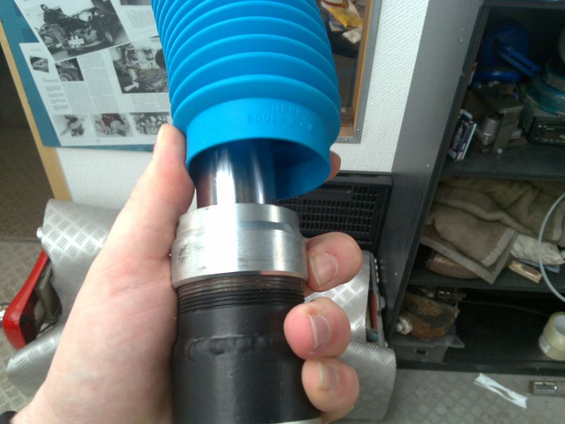

Only up to '86 struts with threaded inserts will accept Bilstein B6 struts with no modifications.
A friend of mine converts later struts with a modified collar to work specifically with these threaded inserts. If interested, send me a pm and I will pass on his contact info.
The guy I know has several sets available. Just saying.
TTM
Well-known member
He sells each set on an exchange basis, so the price is : €150 + tax (german tax) + your set of old struts that must be straight/undamaged.

Then make a final cut as high as you can
Then you can remove old internal parts easily
I suppose 150€ is a fair price when you know how much work this mod needs. Final product is usually as good as new. If some of you still need collars let me know; i can ask if my friend wants to fabricate them.

I guess that's the big question, along with "How long do the struts need to be when the new collar is welded to the top of them?" For reference, the cutting for fitting the Koni inserts is documented here;
http://www.paragon-products.com/kb_results.asp?ID=50
It doesn't involve removing much of the strut (most of the length removed is the crimped-on cap), but how much is 'too much'?
Oli.
Friend said 325mm from the bottom edge should be ok.
