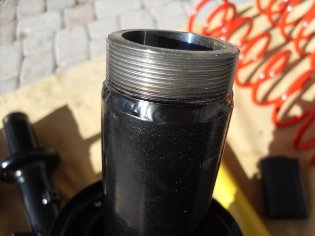

I believed that the threaded collars were post 87 Mo30?? but consider they will however there is a slight strut modification needed to seat the collars.
I only have the collars (brand new) and not the perch or locking ring - part ref 951.343.521.00 - the collar is 54mm ID with a notch to fit onto a protruding 'pin' on the strut as per the photo below (its not my photo).
