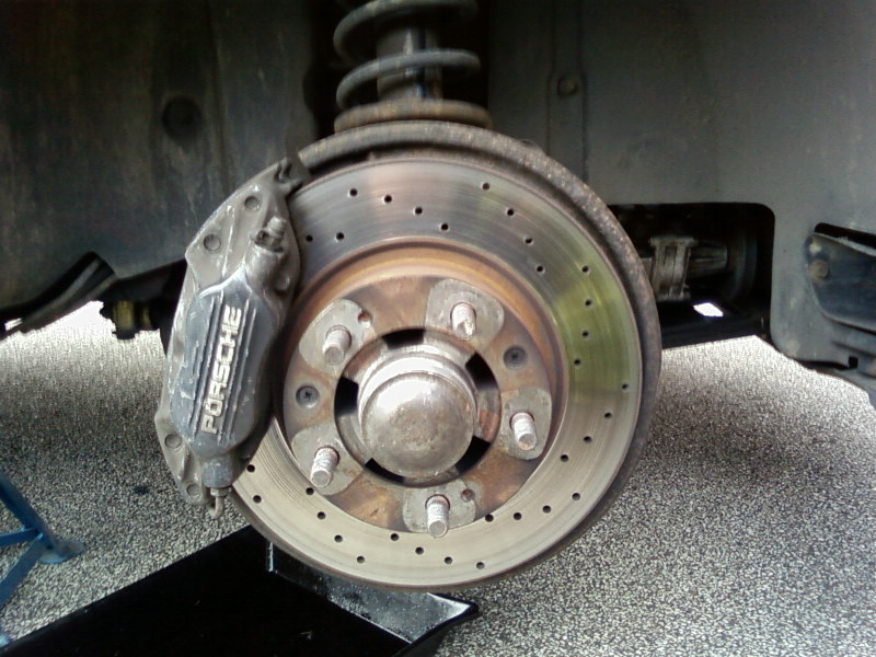

The discs arrived today, delivered in two big boxes. That confused me. I was worried two orders had gone through. But no! The reason it was one disk per package is a pair is too heavy for one man to lift [
I weighed the set up:-
2 Nº 964 Turbo discs
2 Nº big black callipers
4 Nº Red Stuff Pads
8 Nº anti squeal disks
29kg ...4½ stone in old money [
The individual weights:-
1 Nº 964 Turbo disc = 9 kg (1½ stone)
1 Nº big black callipers = 4 kg
4 Nº Red Stuff Pads = 2 kg
It's a shame I haven't still got the original 220 Turbo brakes, just to see how much unsprung weight I have bolted on.

Scott (sawood) emailed me some pictures of a before and after fitting the big blacks to his turbo,i though my brakes were quite big till i saw the big black in comparison !!! i cant post pics but i can email it to someone to post up if they wish .ORIGINAL: carlmthompson
I recon a really useful idea would be to put each type of caliper beside each other, photograph, and then decribe what they're fitted to as standard. Maybe even what they would each fit as an upgrade and what it would take.
So then. Has anyone got one of each type of caliper to photograph? [8|]

I'm not unhappy with what I paid for the callipers - and as Fen said - others can be happy as well. However, by the time you add discs, pads, bolts, fluid, squeal shims (and radial mounts if you don't have Turbo SE struts) you are talking well on the way to £1,000. You also need 17" wheels.
