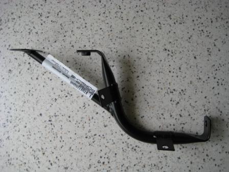

964.504.141.00
Porsche told me today they are not yet flagged as "discontinued" but you just can't get them ...but he suspects they will post the discontinued flag any day !
The only ones available now from Porsche are the RS version 964.504.141.01...whats the difference ;-)
1) Slight smaller in diameter
2) Slight longer in length
Same price each £59+vat !!!
So a new hole, and all will be well..
Old and new on the picture
