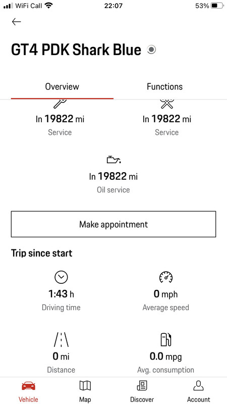

Something not quite right with My Porsche app.
forum
forum
forum
forum
forum
Service intervals are 12k miles and sitting in the car with ignition on setting Settings, entering destinations, loading music, WiFI etc. writes journey time and zero miles travelled into app’s log.

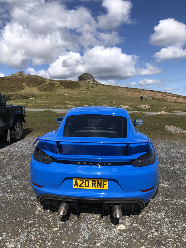

I'm up to 370 miles having visited Haytor on Dartmoor.
and from where you can see the coast over moorland

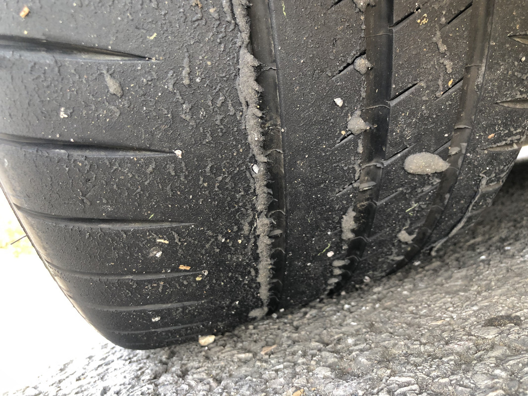

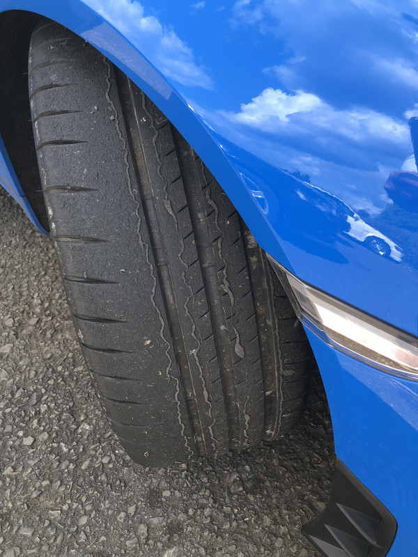

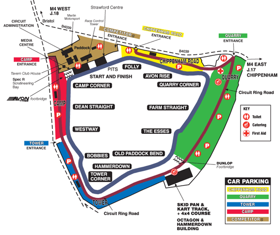

On track at Castle Combe the car was fine, short-shifting a lot but trying to corner at normal speeds. With a new car I like to do a track day then up to Centre Gravity to sort the suspension. Whilst the car felt OK at the speeds I was doing at Castle Combe, the NS v OS wear on this clockwise circuit was quite different as may be seen below.
NSF
OSF
but NSR was not so pretty with OPR and wear towards the shoulder
Folly, Quarry, Old Paddock, Tower and Camp do load the front NS but I have not seen this level of wear before, particularly to the rear.
Tyre temps were <5 degrees difference across the treads, tyre pressures within recommended for Cup2s and Castle Combe is not hard on tyres. In warmer afternoon temperatures (ambient 17c) and perhaps cornering with more confidence, tyre temps were 15c higher than in the cooler morning sessions.
Front brake disk's holes were clear of brake dust, rears not so much - I'll clean them out before Goodwood next week.
We'll see where we get to at Centre Gravity, what the present alignment is and what Chris' thought are, was it alignment, tyre pressures, pilot, other?

As noted, a lot of wear on the outer edges of your nearside tyres, but hopefully the geometry check will highlight some anomalies which Chris will be able to rectify.

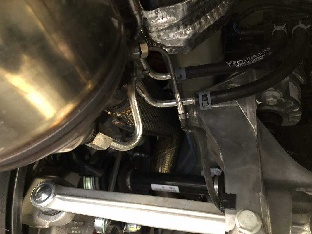

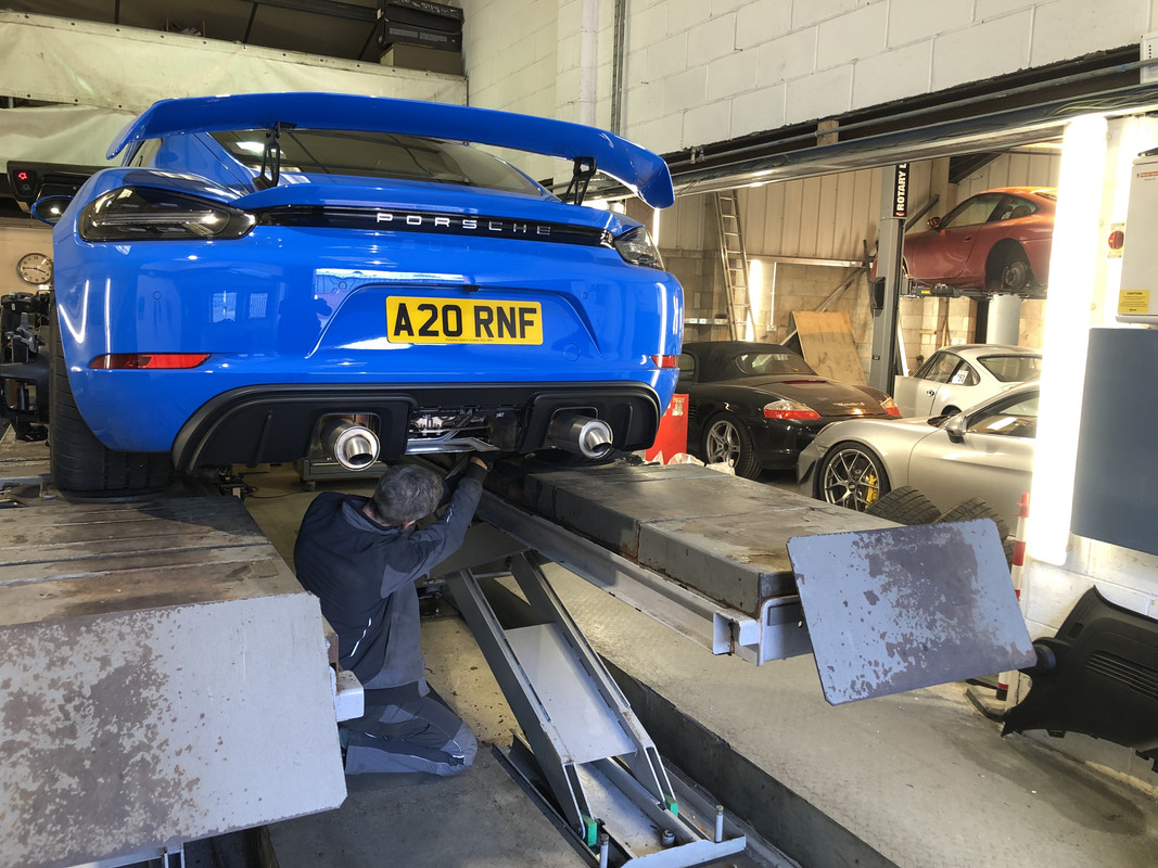

Finished late at Centre Gravity today so I’ll get hard copies of the settings next week.
Main findings were that the rear ride height was greater than spec, and the usual toe and camber not being consistent across each axle. Had an interesting chat about ways around the rear toe control limitation. Picture of Chris working and how clean the suspension components are on a new dry use only (so far) car.

I have now completed 1,850 miles including 3 trackdays, the first of which was with limited revs. The suspension has now been set up by Centre Gravity with settings broadly as my old manual one. The tyre wear noted at Castle Combe was probably attributable to incorrect rear toe and ride height.

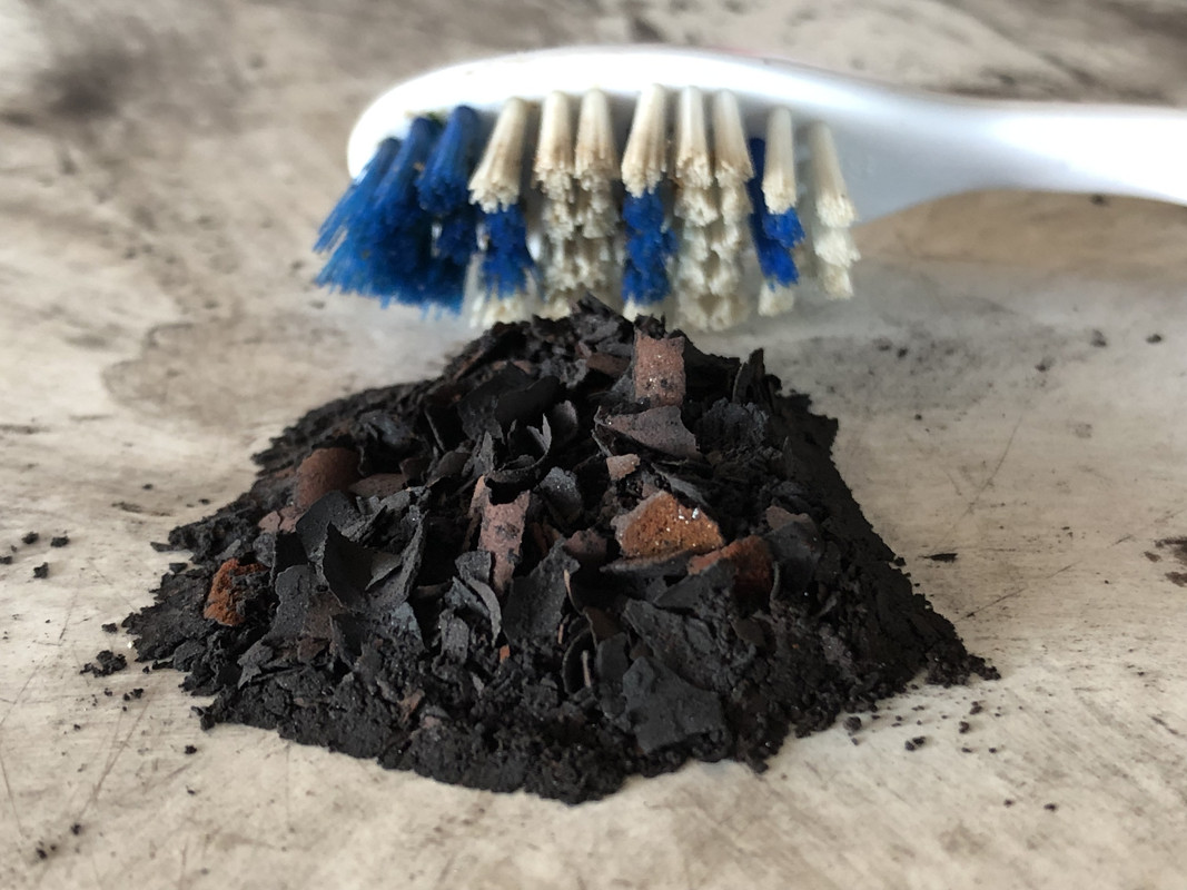

Yesterday was spent cleaning out the drilled holes in the disks, and checking tyre and pad depths. The striking thing was the wear to the rear PFC 332 pads (down to 6mm material from 11mm new) and the amount of debris (pictured below is the junk from just one rear disk) in the holes and from the back of the discs. There was other peoples’ rubber (OPR) in the rear brake assembly and so some of the debris pile is from that. I hate to think how much is lodged in the undertray but out of sight...
Front pad wear (PFC 331) is low, pad depth is 9mm from 11mm new. I presume high rear pad wear is either Porsche’s rear braking stability software intervening or the rear pad material being softer than the front, more likely the former. I never saw this on the manual GT4 so it must be true that PDK is faster 😜 I keep a set of spare pads so I’ll try to get these fitted next week before Castle Combe a week Monday.

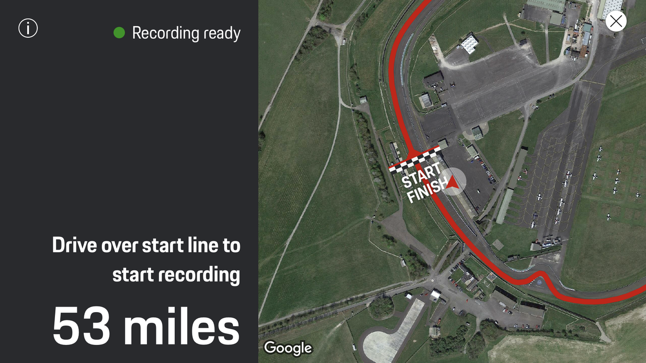

Porsche’s Track Precision continues to be a PTA. The latest oddity I noticed is how far it thinks it is from the pit lane to the start/finish line.
