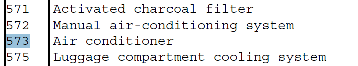

The optional equipment on the gen 1 parts list shows two A/C options, 572 (Manual) and 573 which I take to be the automatic climate control:
Searching the parts list for the unique parts associated with option 573, they appear in three places as shown below.
The one in section 813-045 is the control unit. The other two are relays. That suggests that these are the only parts you need to update to full climate control.1750956083619.png

I am seeing different info on the parts list.
In the 813-005 diagram - part 1 - the "airconditioner / heater box" has a different part number for options 572 and 573
Also part 17 is listed as "resistor" and doesn't have an option listed against it.
but there's an unlabelled blower sensor - which I imagine is the difference in the heater box -i.e. somewhere to locate the sensor.
Also actuator motors (6) and wire sets (looms) (13)
I stopped digging at this point
Wild internet guess here - I think that combo (heater box and blower sensor, actuators etc ) could be the things that mean the fans need manual adjustment if you swap the control panel - by the sounds of it you would go from fullly manual to a digital display of target temp - but still needing to operate fans and flaps manually - so not achieving much (anything) in the way of "climate".

Thanks Paul, my bad. I searched for PR:573 rather than just 573 as you did. As a result, I did not pick up anything that had another option number in front of the 573. Clearly not as simple as changing the front panel.
