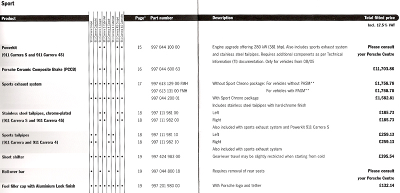

Also, I have heavy doubts about any "˜big' BHP gains some manufacturers like AWE/Tubi/Gemballa claim from just switching the exhaust. Look what Porsche had to do to get a 26BHP gain with the X51 Powerkit option....
Modified cylinder heads
Aluminium intake manifold
Revised exhaust manifolds with larger bores
Uprated engine management system
Carbon-fibre housing for the air filtration system
Sports exhaust unit[/LIST]
Also, Porsche are notorious for understating power figures. I believe most X51 cars which should be pushing out 381bhp are actually achieving 400+. From what I've been told most car manufacturers only have to by law produce something like 90% of their cars to hit the claimed BHP values. Porsche uniquely go with 100%, so I wouldn't at all be surprised if the PSE did indeed add a few BHP. Without dyno'ing before and after it would be difficult to tell.
