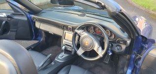

Yes , I have done this, makes a massive diffrence. You need a new wheel, clock spring and depending in which SW you choose , you might need to reverse the polarity of the horn magnet in the air bag , no big deal. It needs a reprogramming and steering sensors resetting.
