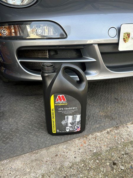

Had my 997-1 2S manual for 12 years. I ensure the oil is changed every year and follow OPC service guidelines fully. However, some years ago I picked up on a recco. for Millers Nanotech oil. The company MD had a 997 and had used this to good results (after some development work). It’s EE nanodrive, 5-40. Bought directly from the UK business, on line. Car runs very well on it, no issues. 10L are roughly 50% of OPC price for Mob 1 at last service. (part no. 7806-5L)
All evidence I can find suggests it’s good for this engine, especially older, higher miles examples. Very happy with it. My car runs clean rear tail pipes, 60k miles. Bore scope check performed several years ago, all clear.

Most specialists I have asked are using Mobil 3000 5w40 A40 in the 997 Carreras, but the Millers NT+ is probably the better oil (just dearer) and I believe is recommended by Hartech. Regardless of oil brand I would change it yearly at a minimum, and if you track the car, change it after a track day.
Oil dilution (and overheating causing cylinder distortion) is the enemy to these engines so using Millers NT + and leaving it there for 20,000 miles would lose the benefit of the highest grade oils.
