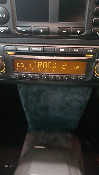

17) pushed CDR23 back in. Turned it on. Cycled to ’CDC’ which was now available again. Paired ‘phone as per instructions. Music, phone working. Bingo! Smug looks all round.
Sounds pretty good, low noise, even works with Siri. Really pleased. Total cost of mods approx £300 including centre console delete.
